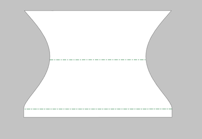

Thats simply 4 pieces welded together at the edges (2 sides are identical and 2 fronts are identical)..
Inventor can easily flatten that..

But something like this.. (not totally accurate)..
