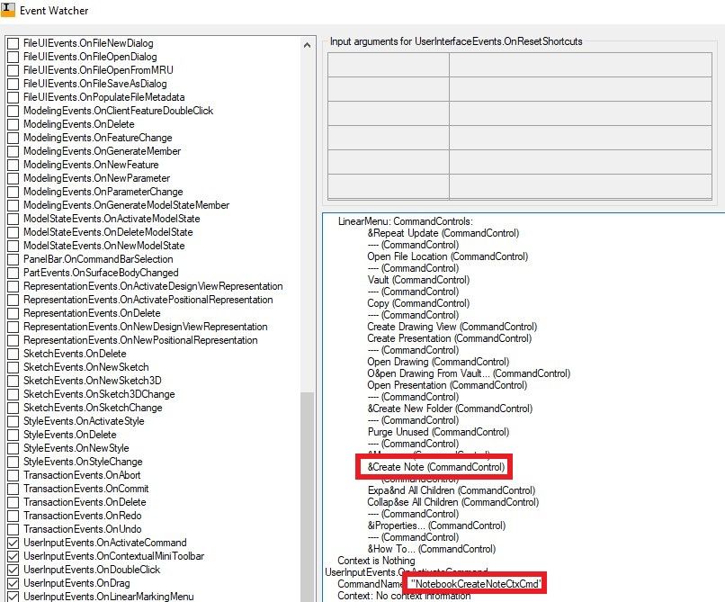

Maybe possible to block the command:
Message 10 of 16
pcrawley
Which version of Inventor are you running?
Nb.dll is responsible for Engineers Notebook.  Disabling it, or not loading it through the use of options via the appropriate xml configuration file leaves Inventor effectively unusable.  @TGibson7A8HD - I've sent you a pm on the subject.
Blocking it looks like an option (Event Watcher is only installed with the developer tools). @Frederick_Law Have you tried it?  It's a feature of Inventor I can definately live without.
Might need to catch OnActivateCommand event and cancel the command.
I was trying to replace it with another.
I don't understand how it can activate "accidentally".
Someone need to right click to bring the menu up and press C twice then Enter.

Frederick_Law
Oh $hit, see if this works:
Sub Main()
Dim controlDefs As ControlDefinitions
Dim IVEngVNotebookDef As ControlDefinition
controlDefs = ThisApplication.CommandManager.ControlDefinitions
For Each controlDef In ThisApplication.CommandManager.ControlDefinitions
	If (controlDef.InternalName = "NotebookCreateNoteCtxCmd") Then
		IVEngVNotebookDef = controlDef
		Logger.Info("Found!")
		Logger.Info(controlDef.DisplayName)
		Logger.Info(controlDef.InternalName)
		IVEngVNotebookDef.OverrideShortcut = "Disabled"
		IVEngVNotebookDef.Enabled = False
	End If
Next
End Sub
