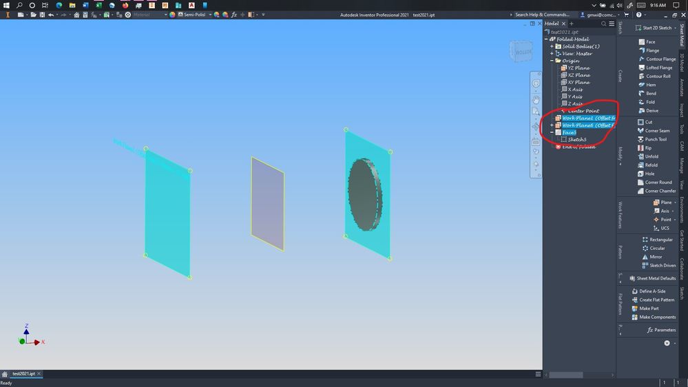

Hello everybody.
I notice a problem in the inventor sheet metal environment by performing the following operations:
- New sheet metal part
- I create an offset plane from the central plane
- I mirror the plane just created and as a reference I use the central plane
- On this last plane, I create a sketch and apply the Face function
The preview shows me a direction of application of the thickness, while at the time of creating the solid, the direction appears to be the opposite.
I found this thing only in the sheet metal environment (not with extrusion) and on the 2022, 2021 and 2020 versions.
Do others find this anomaly?
I attach example in 2022 version and images.

How are you doing? This is an interesting find. I am able to reproduce the behavior in all releases on my machine. It is not unique to 2022. This has something to do with the default direction of a Face. In theory, like Extrude, it should default to the normal direction of the sketch (workplane). In this case, the normal direction is the opposite. I cannot explain the behavior. I will work with the project team to understand it better.

Problem solved sort of. The glitch is with the mirrored function. When you just offset a plane to the same distance then it works as normal. Your sketch is taking direction flow from the referenced plane. That's an approach that I normally don't use. I generally work with created plane and then mirror the features. If you change that procedure then it should be smoother for you.Face Dir2 Correction.jpg
