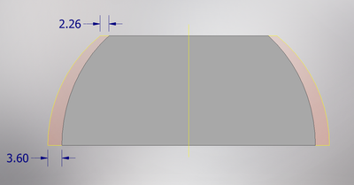

Aaron,
That's an interesting idea and I think it could on axisymmetric geometries but not in general.  I looked at the dome example and applied a 0.90 scale to only the x and y directions.  Applying a single scaling factor won't work when a constant crosssectional thickness is needed.  The picture below shows the scaled down solid and the original surface.  The offsets at the top and bottom are not equal which makes sense with a single scaling factor applied to different dimensions.
