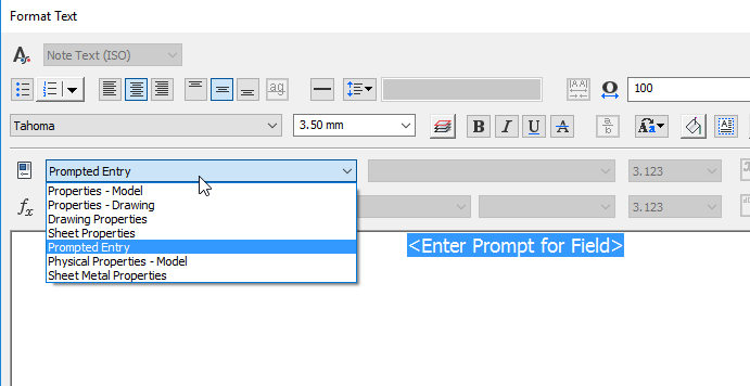

But I could not find the option "Promted Entry" from the drop down menu. Why ?

Hi! It looks like you are in Leader Text or Annotation Text dialog. Prompted Entry is only available within Text in Sketch Symbol. Please share the file you are working on if you cannot figure out.

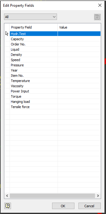

I have one more query. Now I have set of "Promted Entry" fields as shown below. But how can I change their order how it appears on the Edit Property Field ?
Message 8 of 10
johnsonshiue
Hi! Unfortunately, I don't think there is a way to sort it. You will need to delete and recreate in the correct order.
Many thanks!
Software Test Engineer
