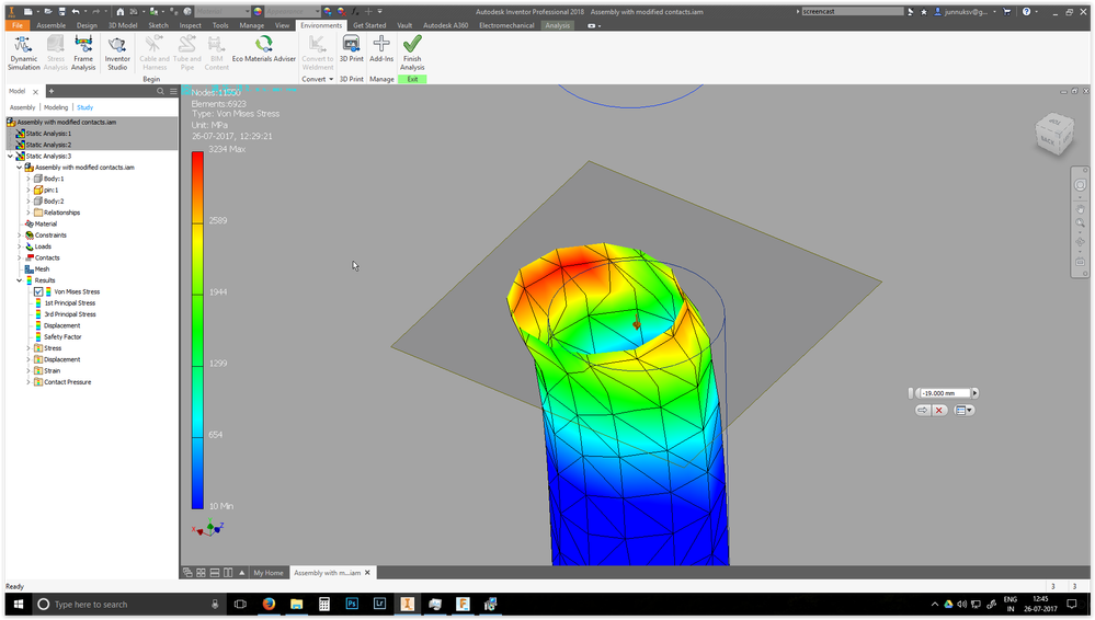

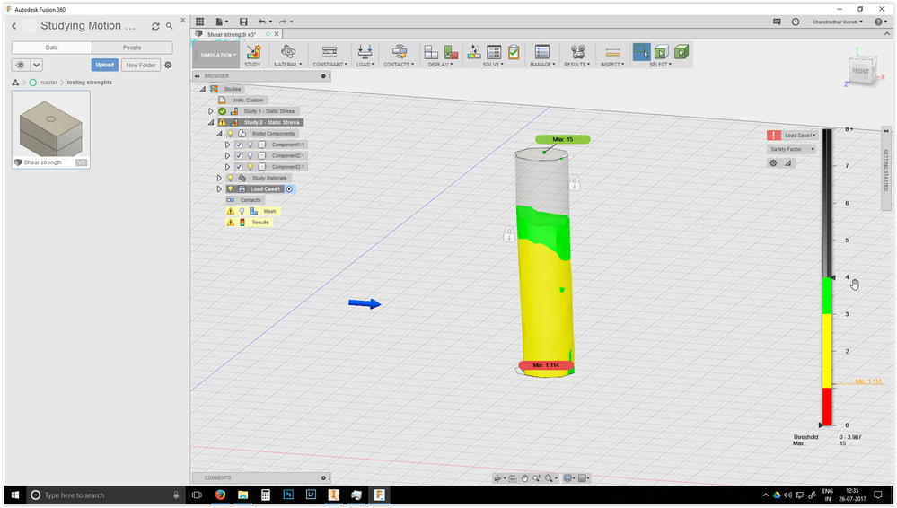

Is it possible to view the different areas of stress concentrations above a certain threshold level the way it is possible with fusion 360 using the handles on the legend? (see images 4 and 5)
Also, is it possible to view a cross section view of the results?
I need to see the stress distribution results inside the core of the object.(see images 1,2 and 3)

Short answer is no, Inventor doesn't have the result viewing capabilities of Fusion.
It's been requested and has been "under review" for over 4 years, every vote helps to get it noticed (again) so please vote for it here:
https://forums.autodesk.com/t5/inventor-ideas/more-tools-for-fea-result-analysis-section-views-scopi...

Is there at least a way to have a section view(to view the inner stresses)
in case having the colour bar handles is not an option.
Colour bar handles are a convenience but being able to view the internal
stresses is a necessity.
I don't get it, how come inventor only shows the stresses on the surface of
the wireframe model!!
Am i missing something??
What do i need to change in order to see the stresses inside the solid??

Same answer as above I'm afraid - you're not missing anything, it doesn't show results through section planes.
Inventor is sadly lacking in its ability to analyse and view FEA results.
