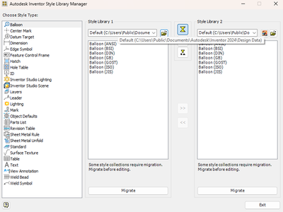

@johnsonshiue Hi thanks for your response, I have opened Styles Library Manager but do not see anything regarding template migration. I have also only ever been on one version on inventor which is common with all colleagues versions.
Do I need to just Migrate all of the different style types over? Do I migrate them into the same location?
Thank you for your help!

Hi Liam,
Style Library Manager helps migrate standards and styles from previous releases to the current release. You don't need to migrate current standards and styles (otherwise, it is a bug). If the standards and styles were last saved in 2023 or earlier releases, please make a backup copy and use Style Library Manager to migrate them.
Please feel free to share the \Design Data\ folder and the template files with me directly at [email protected].
I would like to understand the issue better.
Many thanks!
