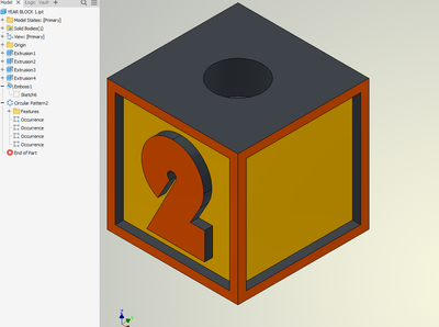

I have a part on which I have an embossed text-based number. I have included the emboss feature in a circular pattern, but it will not graphically show the embossment. If I hover my mouse over the circular pattern feature in the browser tree, the graphics window will show that the embossment IS, in fact, patterned, but it will not show up. How can I make the embossed text show up on all 4 faces?

Try different options in pattern, "Adjust" worked:
TYoung_Combi
Thank you!
