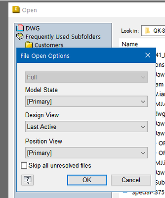

mluterman
Check out the "File Open Options" dialogue box in the "Open" command dialogue box (at the bottom). It's not in Application Options or Document Settings; it's only here.

I pick a part / assembly to place
I click Options... first
I choose the settings I want, i.e. default for all. I click OK.
I click Open, it opens the part / assembly
It opens in master representation...
I pick a different part / assembly to open
The setting in Options... resets to master, so what now?

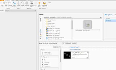

MatthijsAstratec
I also noticed Inventor has a lot of unwanted behaviour.
Here is a video
Here's the other that shows the setting does not save.
