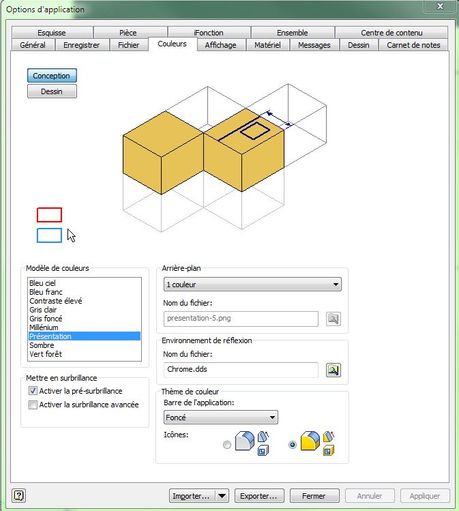

Hi @bengee5454
The color of this line is linked to your application settings / colors.
Just change the colors model here :

Can you post screen shot of your Application Options settings for Drafting?
(I show arrow to the Design Color Scheme in this image, but I am interested in the Drafting environment.)
