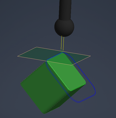

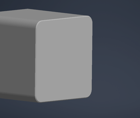

Can anyone tell me how to mill a chamfer on the outside of the cube using a ball-end mill?
I can't rotate the cube, which is why I'm using a ball-end mill—the image is just for illustrative purposes. I'm really just wondering if this is possible with Inventor CAM?

kacper.suchomski
Hi
Yes, it's possible. Please upload your file only after you've defined your CAM settings and added the remaining operations.

Oh, okay, I didn't know that. Thank you. Here's an .ipt file.
I can't seem to get it to display the raw material at the chamfer, but that's where the chamfer is supposed to be milled.
Message 8 of 11
kacper.suchomski
You can use e.g. Flow strategy.

Thank you. Can I use that on the underside too, so that the entire chamfer is machined?
Message 10 of 11
kacper.suchomski
I'm not sure if this is even possible using the available strategies.
It can be done brute-force method, but it would require a lot of manual labor.
Why can't you rotate an object in a holder? Is this some kind of school assignment?
Kacper Suchomski
Message 11 of 11
jdthe09
Community Visitor
Community Visitor
No, unfortunately not 😅. It was more out of curiosity than necessity. I wanted to machine it this way because I wanted to avoid having to swivel the part to save time (mass production). The problem is that the machine can’t move far enough in the Y-axis to machine the part with a chamfering cutter. That’s why I wanted to machine it this way—it would kill two birds with one stone. I’ve now solved this by rotating the part 45 degrees and then using the strategy you suggested. This worked for me at a minimum of 20 degrees, using a lollipop cutter with a 10 mm diameter and a 6 mm shank. Thank you again for your help.
