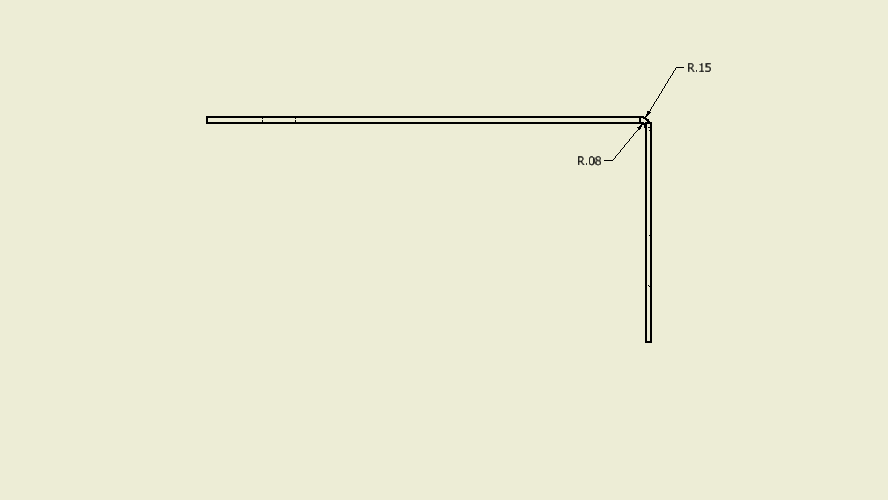

so im working on this (attached) in sheet metal mode and the two metal parts recieved an assumed bend and that isnt a problem, the problem is the radius is /24 and we want it to be .15, how can i fix this?

What's the thickness of your material?

i just used the face tool on a sketch and went with what it gave me, if in inspect the thickness is .12

attach your part...
what version of Inventor
also if you have a thickness of .12 ..and your radius is twice that ... you might want to change your thickness (sheet metal default) to .075 so it'll be a .15 outside radius and a .075 inside radius...
That's typically how bends work

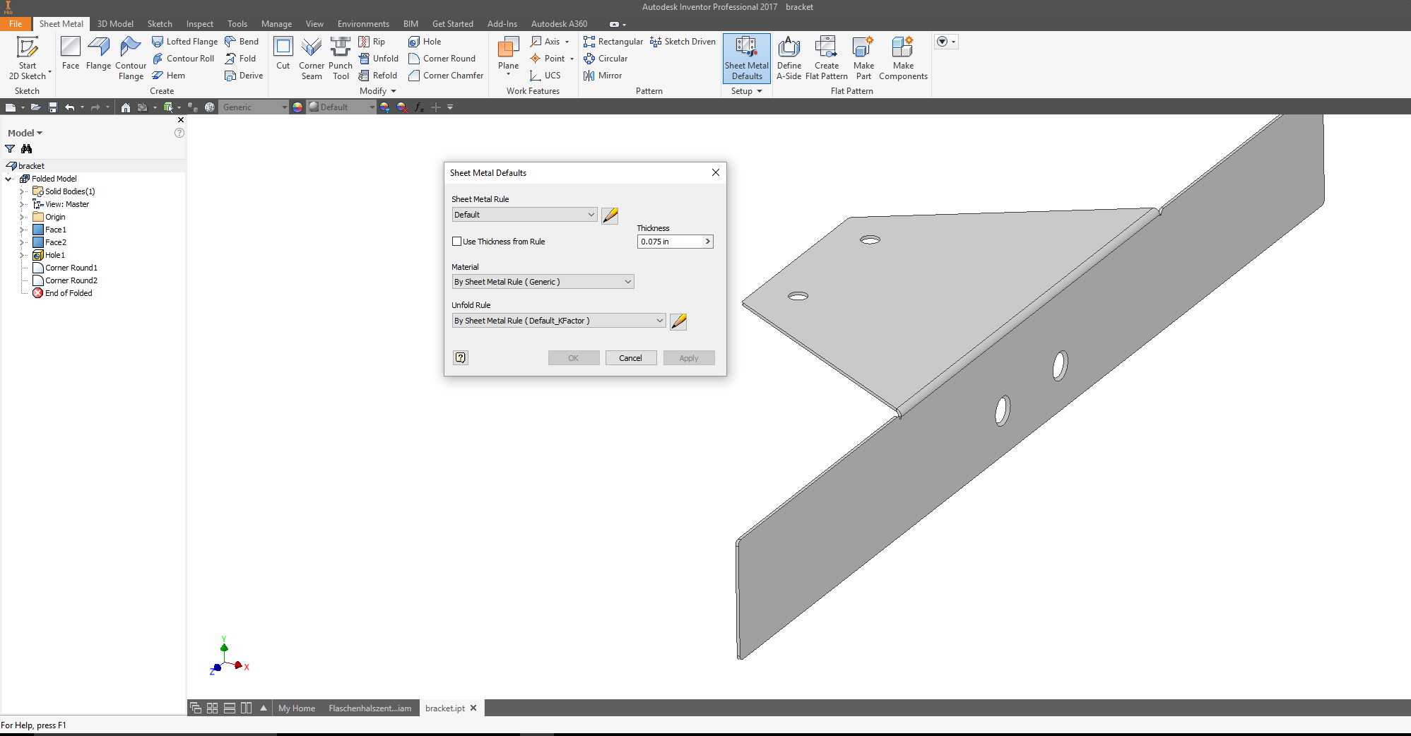

So what do you really really want the Thickness to be?
Sheet metal bends are normally specified to the inside radius - not the outside radius.
Both the Thickness and Bend Radius can be set in the Sheet Metal Styles.

sorry i am really new to sheet metal modeling, i am great with normal 3d but i dont know... i have attached the part and will try what you said
Message 7 of 13
mdavis22569
start there with the right thickness you're looking for ...

i sort of kind of changed it and changed the thickness
Message 10 of 13
mdavis22569
you now know how to change the thickness ..
however as JDMathers said you have other issues to fix in the ipt ...
