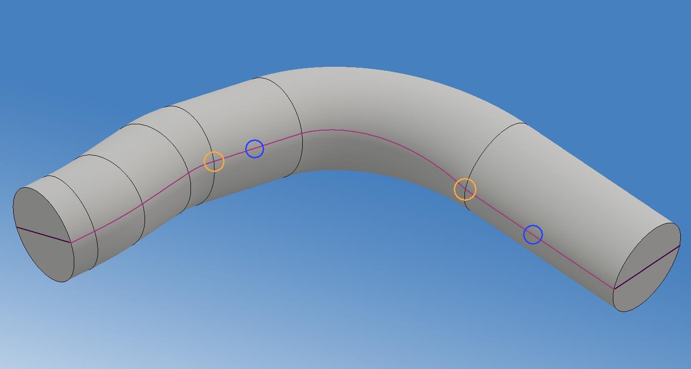

As mentioned earlier, 2016 silhouette curve is buggy. You'll have to use a workaround.
Look at the picture.
If you zoom in close enough at the orange circles, you'll see disconnected segments, over all there are 4 spots. Therefore no boundary patch can be done.
Remedy:
- Supprees visibilty of Clamp Blocks
- Double-click on 3D Sketch3
- Right-click on Silhouette Curve1 -> Break link
- Delete lines marked in blue at both sides of the cylinders
- Select all remaining curves and lines and apply fix constraint.
- Now create new 3D Lines between the open ends
- Finish Sketch
Now Boundary Patch is possible.
Walter
