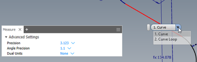

Did Autodesk drop the ball on the measure tool again?
How do I find the Length of the Cut Extrude inside the rectangle?
WITHOUT HAVING TO DO MATH!

The feature is there in 2019, but so far the description how to access it has been terrible:
  1. Select "Measure"
  2. Hover over one section of the sketch until the alternative option dropdown appears
  3. Select "Curve Loop"
To the best of my knowledge there is no way to export this as a live parameter.

@Anonymous  Andy, you can edit the sketch and create dimensions (arc lengths for arcs) for each line or arc (even if driven dimensions) and then create a "live" user parameter that adds them together.

Hi! Indeed, the Measure tool passively reports the measurement. It cannot convert or capture the measurement has a parameter. There is a way to get the loop length by creating a sweep feature of a circular profile along the path. Then find the volume of the body (via iLogic) and divide it by the circular area.
