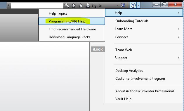

MechMachineMan
@Anonymous wrote:
This when i use the last code i posted.
in english:
Impossible to find pubblic member "FileName" in tipe "_DocumentClass"
Yes, so exactly as it says, the method "FileName" that you are trying to call is not a valid method for the class that you are trying to call it for.
You have oDoc.FileName... Well oDoc is an object of the Document class, and you are trying to call the method FileName from within it.
What that tells you is that the class has no clue what you are trying to tell it to do, because FileName is not a recognized command for it.
Whenever you see this error, just go look up in API help a similiar method that will accomplish what you need by search for the class first.
Open it up as shown in the window below, select the search tab and look up "Document".
Good luck.
