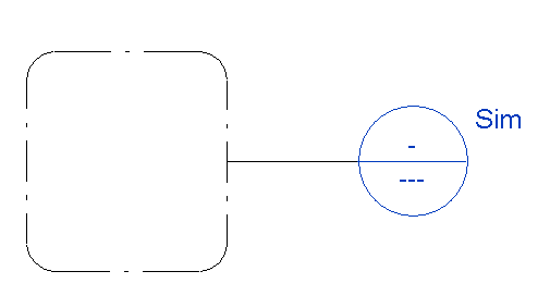

We are evaluating software for use in architectural millwork. We like all of Inventors capabilities but are put off with the very mechanical look and feel of drawing elements.
I would like to create custom drawing labels, Section call-outs/labels, detail call-out/labels and elevation tags.
I want these elements linked to the drawing view(s).
We usually separate plan, elevations, sections and details on different pages so a detail call-outs will need to reference the initial view.
Below are examples of what we want:
Is any of this possible with the API?
Drawing label example. Scale linked to the view. This would be for top, front and side views.
Section call-outs similar to the 1st in the image rather than the last two that are standard in Inventor.
Square detail call outs with a leader to the call out symbol.
Finally elevation call-outs for the top view that will reference front and side views.

MechMachineMan
Auto implementation with API? Mostly.
Implementable through the default applications UI, with required user inputs? Yup. You create sketched symbols and input them into the drawings as required.

As for the auto implementation, could you expand on mostly?
I am aware of being able to create symbols but they will not have a link and require the user to ensure that any changes made to the parent are applied to the child and visa versa. For instance changing the section letter on the parent or moving the detail to another sheet.
We would like to remove the possibility for human error wherever possible.
Not to mention changing the look of the detail call out and section line are not really possible with standard UI. We would need the ability to turn off the default graphics and replace them with symbols. From what I have seen this is not possible.

Thanks, I was able to hide the section and detail lines by changing the layer of that object to one that is hidden. Then adding custom symbols over the parent view will be an acceptable workaround until coding can be done to automate the relationship from parent to child view.
Having it automated is the end goal. The point of this thread was to verify if the time to research how to implement the desired functionality is even worth the effort.
I have done scripting on other software only to run into a dead end where the API did not offer a way to connect to and reference the features I needed.
Knowing that what I am after is possible, I can now confidently start researching what exactly is needed to accomplish the end result.
