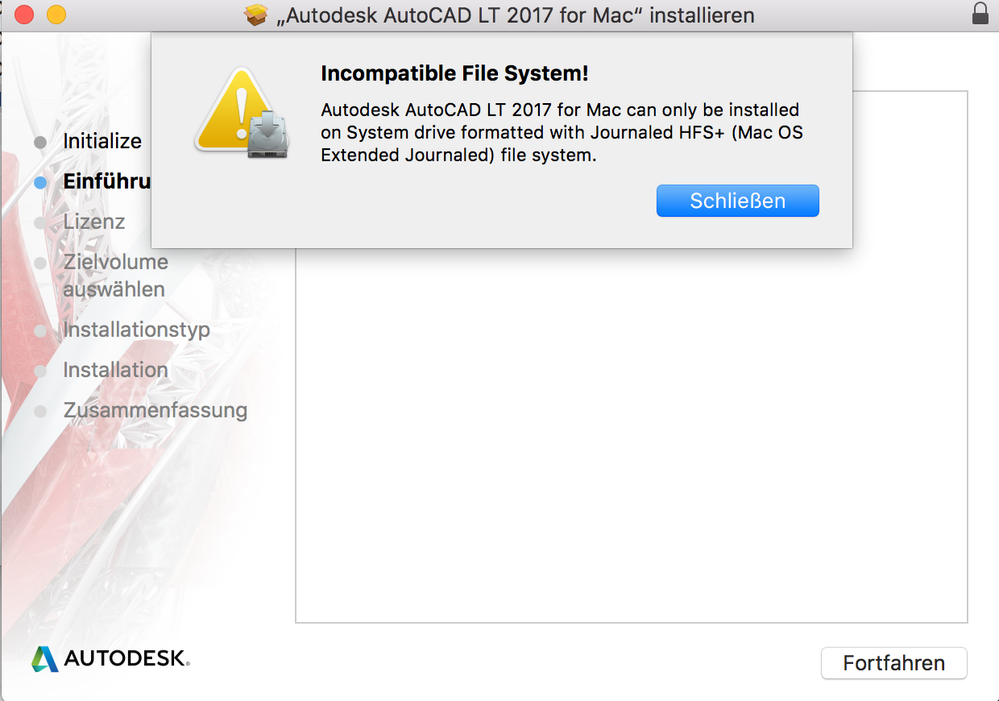

thanks for the quick answer. Actually Im a student and I using AutoCad for my masters. So I only allowed to download AutoCAD 15 as a Mac version. Do u have any idea to get AutoCAD?
Message 39 of 42
Mark.Lancaster
@Anonymous
I'm confused..  You have access to AutoCAD for Mac so why are asking how to download it.  Are you asking for the 2017 version and requesting it?
Mark Lancaster
Message 40 of 42
@Mark.Lancaster
sry for miss hitting the key, I mean 2017.
Actually I can't install the 2017 Version for Mac. Bildschirmfoto 2017-10-19 um 13.16.18.png
sry for my bad English.
lets do it the easy way. is their a possibility to install the 2017 version for Mac on high Sierra?
