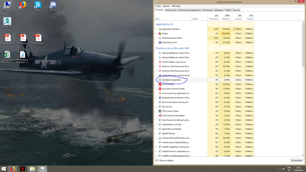

I also noticed that when it closes, a task named "Autodesk component" appears in my manager, but no new window nor message box pops up.

Here are some screenshot in case I was not clear enough :
The first pop-up
Then if I click "Single user", if I choose "enter a serial number", it exits
lauched.PNGAnd finally, when I click "Already have a license ?", it exits as well and I have a "ghost" task
