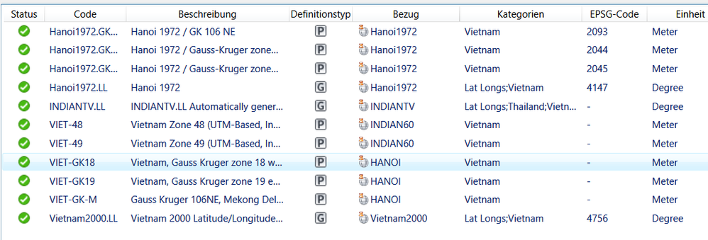

did anyone ever operate with Vietnam 2000 coordinate system? If used it seems to not provide a correct set of coordinates...

The problem seems to be in the definition of the Vietnam2000.LL coordinates system.
In the model properties,  I've changed the coordinates system UCS from  XY-M to Vietnam2000.LL but the coordinates  shown at the bottom left of the screen are not updating. The other Vietnam coordinates system are working perfectly but I'm required to use this one.

a XY-M coordinate system only defines a system with x and y axis and metric units. There is no reference point or any other transformation definition available. The geodetic transformation information between coordinate systems must be available to have InfraWorks transform on the fly.
Your UCM is XY-M, how about the database CS, is it also XY-M?

Unfortunately no. Consider that Vietnam2000 coordinate systems does rely on LL system but origin seems to be translated to Hanoi.
I've found this:
From MINISTRY OF NATURAL RESOURCES AND
ENVIRONMENT, SOCIALIST REPUBLIC OF VIETNAM Day 27 month 02 in 2007
Article 1. Now use the system parameters to switch between international coordinate system
WGS-84 coordinate system of national and VN-2000 is as follows:
1. Parameter shifts the origin:
-191.90441429 M; -39.30318279 m; -111.45032835 m.
2. The coordinate rotation:
-0.00928836 " ; 0.01975479" ; -0.00427372".
3. Scaling length:
k = 1.000000252906278.
Do you know how to set them in infraworks?
Thank you

there is no possibility to edit or create a coordinate system (CS) with InfraWorks tools, you need to have Civil 3D or Map 3D available to do that.
I have double checked the coordinates in Civil 3D and can say that there is a correct Geodetic Transformation info available for VietnamLL.
But when connecting to the InfraWorks sqlite file via FDO connection and changing the CS from LL84 to VietnamLL in Civil 3D there is also no change in the CS display.
Please confirm that it is expected that the CS displays numbers closer to 0,0 as the origin point was moved to a reference in Vietnam.
Do you have any data available that has VietnamLL coordinates, for example a shape file? I would like to do some more tests and forward this issue to our development team if the transformation still does not work.

civil 3d use only projected coordinate system, while Vietnam 200 LL is GIS coordinate system. Vietnam 200 LL  can only applicable in MAP 3D. so during opening infrawork model in civil 3d select WGS84 zone 48 for Hanoi region and open model, but still your roads and other feature will be slightly at different location due to geodetic transformation from LL84 to UTM. so to solve that problem  go to edit drawing settings and in transformation tab  check apply transformations setting , then apply and zoom to extent, hope this will work.

I'm actually encountering problems when importing civil3d file (in Vietnam2000) in the Infraworks model. In fact, the civil 3d Model (set in Vietnam2000, as in pic. 1) is imported far from the expected position. Do you know how to correctly set the infraworks importing (pic.2)?
Civil3D.PNG     pic2pic2
