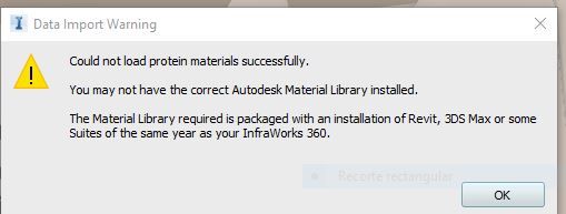

When I imported a Revit Model to Infraworks, the following warning appeared:
When IW imported the model, it completely looked grayed colored.
Can the problem be that I already installed Infraworks 2020 and Revit is still on 2019 version? Or the issue is otherone? If so, how can I solve it.

Hi @Mpcconsultora; thanks for sending me that model!
Please check that you have material libraries installed for 2020. I've attached a picture of my control panel for reference.
Please also check that the Override All Materials is unchecked under the 3D Model tab of the source configuration.
I should also mention that custom materials/textures from Revit will not come into Infraworks. It appears that some in your model were custom, but others came in better for me that the picture you attached.

Hi @Mpcconsultora
I know you have Infraworks 2020, which is why you need to make sure that you have the 2020 materials library installed (see my previous post). It should have installed with Infraworks 2020, but perhaps something went wrong with the install. If you do not have it installed, please follow this article to install it.
If you do have it already installed, then perhaps your source configuration is incorrect. Please see my previous post to make sure that Override All Materials in unchecked. Note that your custom Revit materials will not come in; I got a message when I imported your Revit model saying that there were some custom materials.

The problem is that the Revit version that I still have is 2019, en the Revit model is in that version. I tried open the Revit Model (2019) with InfraWorks 2019 as well, and it opened it adequately.
My question would be: How can I solve this version problem without updating Revit to 2020?

Hi @Mpcconsultora ,
can you install the Material Library 2020 separately from this site and test again?
https://knowledge.autodesk.com/support/infraworks/troubleshooting/caas/simplecontent/content/to-inst...

Hi @Karsten.Saenger
As I mentioned @wpagl452, the solution to my problem was using Revit and Infraworks in the same version. I haven't installed Revit 2020 or other AEC Collection yet, excepto Infraworks. So I go back to IW 2019 and I could see adequately the materials.
My problem is still that I don't undestand why is it necessary to scale a Revit model into IW as if the revit was in Feet, because I'm working both in metric units.

I still think the issue could also be solved by installing the adequate (full) 2020 material library. I know that it's hard to find it online as separate download.
In the past, I helped my self by downloading the 3ds Max installation files. I searched for the material libraries in the installation folders and just installed these. Probably, the same can be done with the Revit installation files (haven't tested this).

Hi @wpagl452
I tried importing the C3D file with the Revit model and I got the following errors.
Hi @wpagl452

In my opinion the scaling issue affects FBX format as well, at least in this case. Configure the FBX file using feet and then the model is correct in Infraworks (I just tested this). I have not tested the Civil 3D workaround using your files, but if you configure using feet, you won't need to use the workaround.
All the best,
Winston
