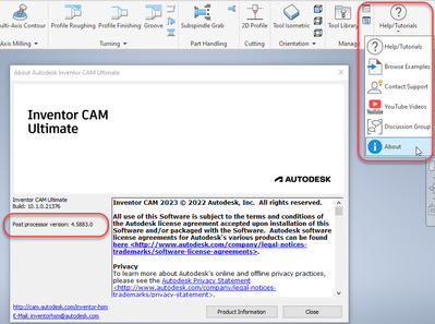

If you want to find out the postprocessor version which is currently installed on your system you have these options:
  • Post process any toolpath with the “Dumper” post processor (dump.cps). It will show the installed post engine version at the top of the output file.
  • For newer versions of the desktop products Inventor CAM and HSMWorks, navigate to “Help/Tutorials --> About” and it will show the post processor version.
  • Look at the error message you got from post processing, for example:
    Error: The post configuration (.cps) requires revision 45909 or later of the post processor engine which has revision 45843.
Note, the post SCRIPT file version numbers do not correlate with the post ENGINE version number.
