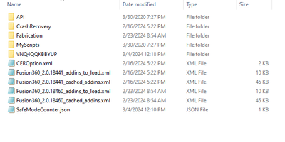

lets keep working on this:
1. Close down Fusion and make sure that task manager does not show any running Fusion exe
2. Go to C:/Users/USER ID/AppData/local/Autodesk/Autodesk Fusion 360/Can you capture an image of the folders you see in here?

crueby1
Here is what is in that folder:
Message 25 of 53
RajkumarIlanchelian
@crueby1 Can you please delete the folder "VNQ....." and start Fusion again. It should ask you to login again and let me know if the untangling wires goes away.
