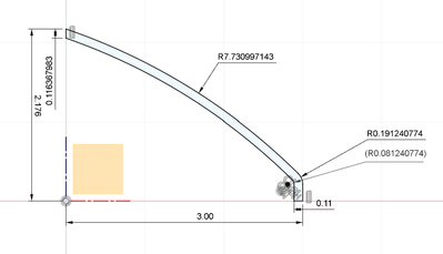

Step 1.  Start a new file.  Start a new sketch on the XZ Plane.
Sketch a vertical line from the Origin a length of 2.176 as shown below...
Right click on the line and select Centerline.
Now sketch a Horizontal line from the Origin to the right and a Vertical line from the end of the horizontal line...
Dimension as shown.  The Ø6.00 diametral dimension is achieved by selecting the centerline.
Sketch a 3-Point Arc and dimension as shown (I had to guess the actual dimension as your sketch didn't make logical sense for this radius).
Now Revolve the sketch about the centerline.
Add a R 0.2 Fillet to the edge as shown below (it is almost always better to add Fillets as placed features on the solid body rather than in sketch.  I had to guess on the Fillet radius as your model didn't make logical sense.

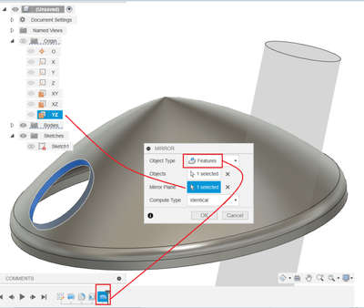

Mirror the Feature about the YZ Plane...

Now start the Mirror command and set to Object Type > Faces.
Select the face of the small hole as the object to mirror and the XZ Plane as the Mirror Plane...
Run the Mirror command again, this time selecting both small hole faces and the YZ Plane as the mirror plane.
