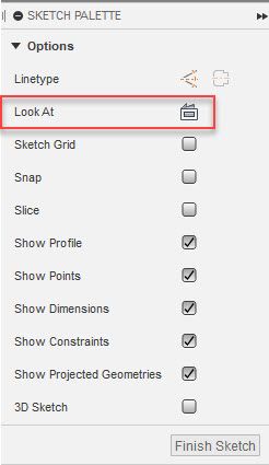

When I start a sketch, I select the face I want to sketch on and then that face zooms completely off my screen. The origin is placed in the center of the screen instead.  I have to reposition the view in order to complete my sketch. Why does this happen?

davebYYPCU
Check your Preferences,
Auto Look at sketch on creation, zooms to fit all that is in the sketch,
a new sketch only has an origin, so it zooms onto the Origin.
Auto Project references to the sketch on Create has a similar effect, but you still have to see the Origin in the Fusion system.
Might help....

davebYYPCU
Then you would turn it off,
which means you do it yourself with, Look at (this face).
Might help......

jhackney1972
If you have turned off "Auto look at sketch" in your preferences, when you start a new sketch you can find the Look At command on the Sketch Palette.
