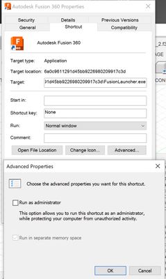

Is it possible you've set Run as administrator for Fusion app? If so, please close fusion and uncheck "run as administrator" from shortcut and compatibility. Let's see whether it works for such case.
Right mouse click on fusion icon, uncheck the two "Run as administrator" checkbox and restart fusion afterwards.

unordmtlr
I've sent you link the the files from IDService log folder via private messages.
