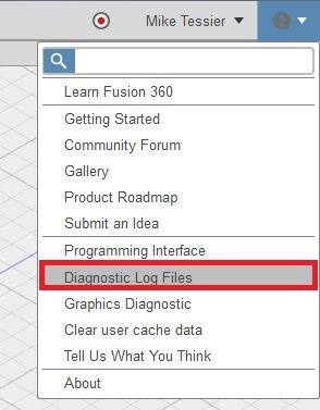

Would you be able to send me your diagnostic log files? To collect these, launch Fusion and click the "?" in the upper right corner. Then, from the drop down select "Diagnostic Log Files" as shown below.
