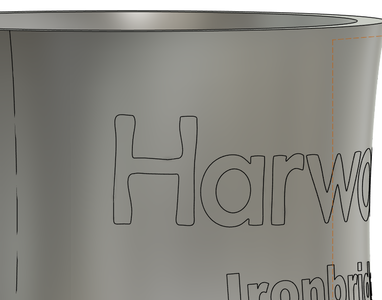

Hello, I have noticed some strange behaviour when I try to emboss an SVG profile onto a curved surface.
If you look at the screen clip, the sides of the 'H' have some strange curves on the emboss feature, but the sketch has straight edges.
I have also embossed some plain text onto the same surface, and no problems are seen.

another one not working as it should

Warmingup1953
I think it may be the geometry of the .svg isnt ideal.
Here is your H from the .svg
and here is one from a Project Salvadore Autotrace of a screen capture of the .svg opened in CorelDraw...Not great but better:
and drax:

Rollmop
I have created another test flat, curve and semi sphere, and just embossed simple text 'Arial' and a slightly more complex font 'Wingfoot',  it seems to handle the simple text ok, but struggles with the wingfoot on a compound surface
So I guess it's a bug in Fusion. I am sure the calculations are massively complex, but need tweaking

TheCADWhisperer
@Rollmop
Try Explode Text (you will have to resolve the Emboss after changing).
I also noticed that your original design could be significantly simplified.

Rollmop
Tried that, does not seem to make any difference
