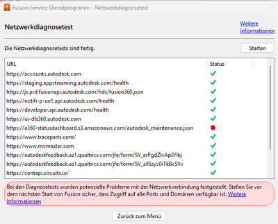

Hi
I need some help.... i have a network problem... and i tried and read a lot of options... but i dont know how can i fix it...
I have a red dot next to this:
https://a360-statusdashboard.s3.amazonaws.com/autodesk_maintenance.json
And i dont know why...

@vyviora0 This is the link where Fusion connects to the Autodesk Health dashboard to determine the health state of Fusion. A firewall could be blocking it but if you simply logout/close/restart machine/restart Fusion and login again does this still fail?
From a Fusion usage standpoint it should not impact your work.

@Mat4Shell If the network diagnostics is the only this that is showing this red and from a Fusion standpoint you are not having any issues, then there are no other issues happening here. We will be removing that link for the checks shortly.
