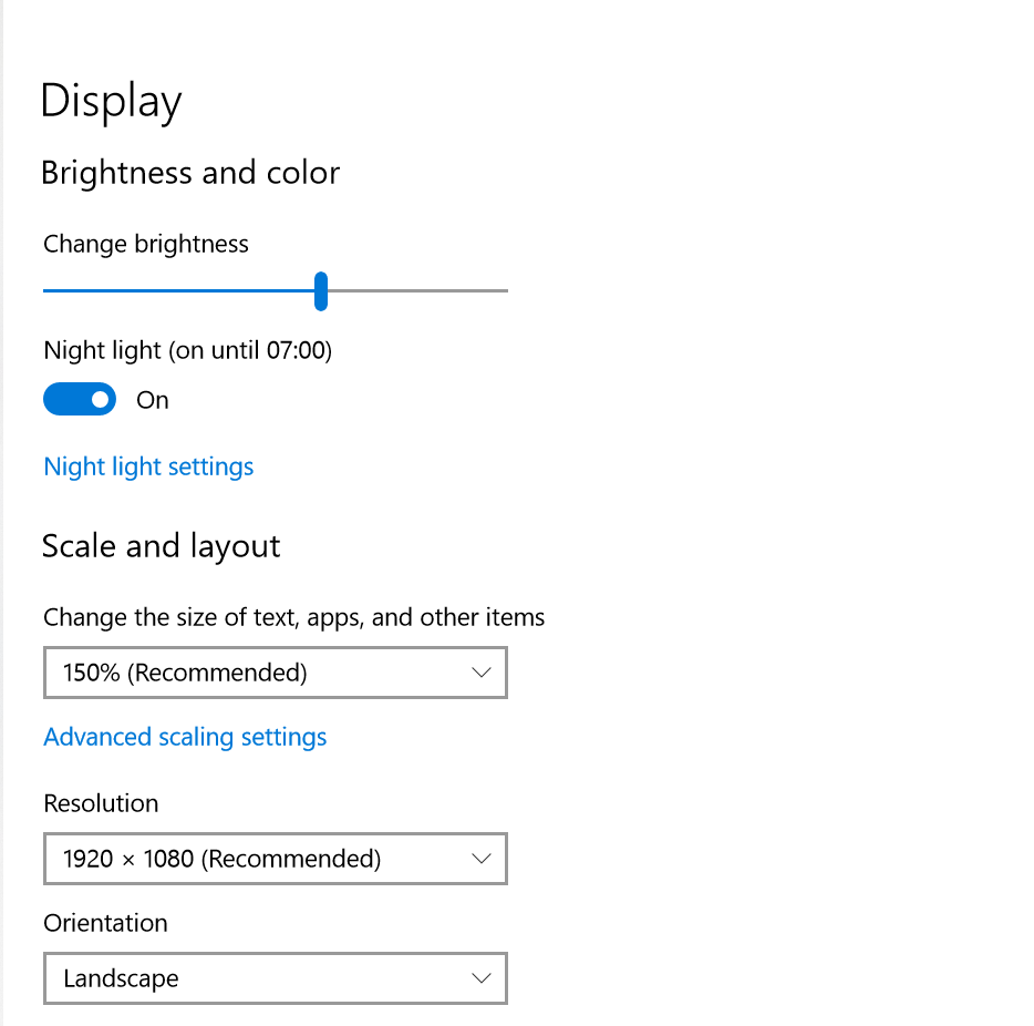

If this is graphics related we need to check everything:
What is the screen resolution?
Display scaling?
How many monitors? 4K? External?
If so does it work on the laptop screen?
Do any files work and operate fine?

Message 13 of 14
Message 14 of 14
baribak
Sorry to hear of the continuing challenges.
Can you try setting the "Size of Apps" to 100%?
Also, can you send us the log files?  These can be found in :
C:\Users\username\AppData\Local\Autodesk   - streamer.log
C:\Users\username\AppData\Local\Autodesk\Autodesk Fusion 360\logs AppLogFiles
C:\Users\username\AppData\Local\Autodesk\Web Services\logs
Kevin Baribault
