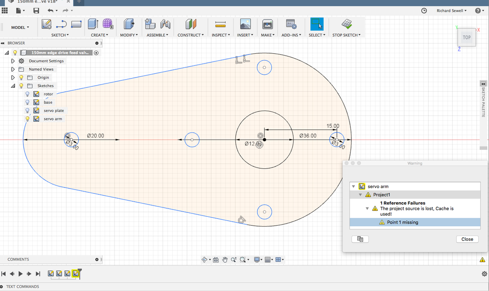

jarkman
This warning tells me the name of the point it *can't* find, but that's not useful to me in working out what to fix, since the point is no longer present.
What I need to know is what depends on that point. Perhaps the affected constraints or sketch objects could be highlighted when I click on the warning.
Even more helpfully, as it clearly knows where that point used to be, perhaps it could offer to recreate a suitable point for me ?
There's also a mismatch here, where the warning refers to the point by name, but the rest of the sketch UI takes care to never show names of sketch objects, and (as far as I know) there's no way for me to set or see these names.
This would all be a lot easier to use if (eg) the selected object description in the bottom right of the screen could show the name of a selected object. it could also show the names of the objects involved when a constraint was selected.

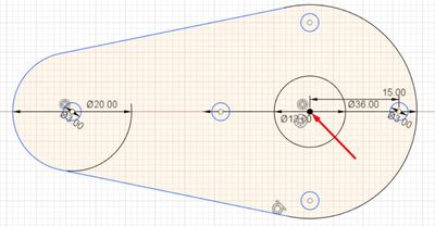

Hello @jarkman,
thanks for posting and for the feedback! I noticed that the following point is causing trouble:
Deleting the point and re-drawing the features that were centered around will allow you to get rid of the warning (see the fixed model here). While there is no direct way to follow the errors in the sketch geometry, which might make it problematic especially in complex sketches, the icons and the color coding for the constraints might give you some hints of how to proceed with the warnings.
In this particular case, it led me to the center points of the d12 and d36 circles. They were both fixed to a point from "base" sketch and cocentric.
I encourage you to post your idea in our Fusion 360 Idea Station - I'm curious to know how many users struggle with this issue.
Please accept as solution if my post resolves your issue, or reply with additional details if the problem persists.
Best regards,
Paweł Potyrała
Technical Support Manager
Global Product Support
My Screencasts | Fusion 360 Webinars

pawel.potyrala
Hi @jarkman,
I admit I destroyed three of the d3 circles created with the circle pattern to make sure I do everything correctly. One circle (to the right) was left in peace. What I did after that is as follows:
  1. Deleting the center point of d12 and d36 circles with all the constraints
  2. Fixing the circle to the left side temporarily to prevent it from moving
  3. Moving away both d12 and d36 circles
  4. Adding coincident constraint between d12 circle and the point from "base" sketch
  5. Adding concentric constraint between d12 and d36 circles
  6. Unfixing the circle to the left
  7. Creating the circular pattern with the d3 circle.
I hope it helps. Thanks in advance for posting in the Idea Station!
