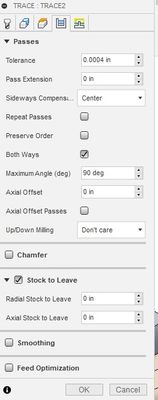

So i tried to use trace to make slots from a sketch, but it makes only traces, normal maybe, no slots. I changed the bottom height but it does not go deep in the wood. I tried slot, but it wants pockets, and i don't have pockets, only a sketch.  So help would be fine...

If you are using the 2D Trace to follow a sketch line then under the Passes tab there is an option to do multiple depths using the "Axial Offset" facility.

OK, thanks. Let's keep 2D trace for now. So for a depth of 4mm with passes of 0.25, i must have 16 setpdown? I thought it was managing the number of setpdown itself... And what about the bottom height in height tab?

16 x 25µm passes? It looks overkill! You must feed fast... You don't mention axial offset?
AFter doing the maths, i found that a pass should be 0.25 mm feeding at 400 mm/mn.
For my first try, i asked 0.5mm passes at 1000 mm/mn, the O.6 bit broke at once. Funny, but i had only one of these bits.

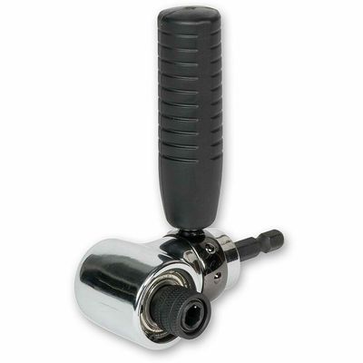

Suggestion, this something I have done in the past, buy a right angle adapter similar to the one in the image and use a Slitting Saw for your slots, it will do a slot in a single pass easily in wood, well worth the cost and the bit of work to adapt, the one I bought years ago isn`t around any more but there are lots of them that can be easliy adapted for the job. I used to do similar small width cuts in Aluminium, work great 🙂
Doesn`t have to be this particular one but it get the idea across 🙂 🙂 🙂

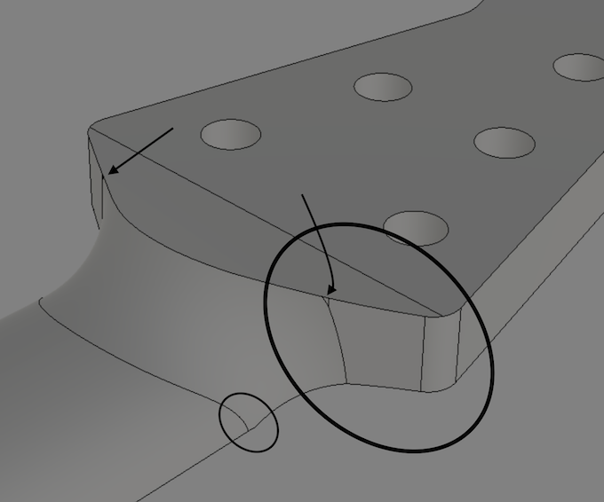

But about the 3D finish, you seem to use parallel operation pour the radius, i used it also with success. But for my back of neck, i used scallop, and the tool did not go to true depth and now i've got a reverse filet on the neck. I not the first time i'm disappointed by scallop, do you make the back of the neck with parallel?
Can i do all the finish with parallel?
About simulation, is it possible to see the part after simulation.
I'll post pics...
my file https://a360.co/2V1bt5p
my scallop is "scallop galbe" in "manche dos" set up

The picture of the non finished scallop :
Message 18 of 25
daniel_lyall
The bits the arrows are pointing to select them and delete them, the bits in the circles are part of the problem it is a dirty surface, just deleting the 2 bit the arrow is pointing makes a difference.
It is more of a selection issue the tool is going to where it is meant to go, it needs to go past there what is not an easy thing to do.
In the attached file I have given you 3 options I have the center of the tool going to the center of the toolpath edge with the tool outside boundary and the -.01 offset and using the avoid/touch surfaces command to stop the cutting go to places it does not need to go to as the contour toolpath will do it.

how do you delete a line like this? I can select it, but after? I tried right click and delete, but it don't delete.
Message 20 of 25
daniel_lyall
Just what I show in the video delete.
