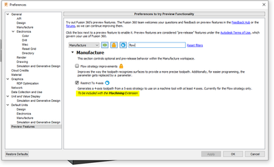

That's because it is a 5 axis toolpath. The option for 4 axis limiting shows up on the Geometry tab of the toolpath (no clue why they put that there)

Message 13 of 25
seth.madore
It's in Preferences:
Seth Madore
Message 14 of 25
jswickJ9PWC
Turn it on in your preferences under "preview features"
