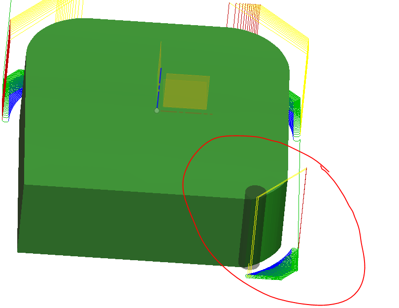

Thank you Seth. Its a lot faster and its attacking the corners first now, which is good. The only thing is the way it takes the corners off is it first nibbles side to side (climb only, lead in and lead out enabled, keep tool down), but after a few passes, it starts going over the corner to start the next pass. Any Idea why? Pics attached of first few passes in blue and then the raise and move passes in yellow.  Contour 3.PNGContour 4.PNG

seth.madore
Hmm, could you share your file so I can see all the settings you have selected?

seth.madore
It creates these passes by offsetting and then trimming the chain as needed. To overcome this issue of "clipping" the stock, increase your lead-in/out values to 2mm, this will allow it to scoot past without touching stock on it's linking move back to the start

seth.madore
Furthermore, if you WANT it to lift up between each cut, turn off the "Keep Tool Down" button

nealkriegler
Ah excellent, thank you Seth. That worked great!
