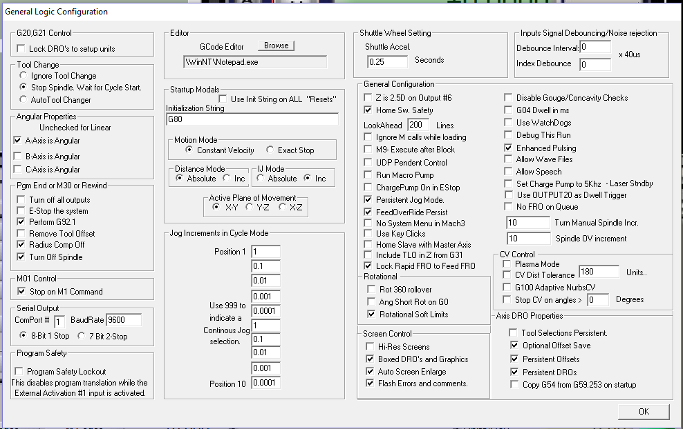

@Anonymous you have IJ set wrong second pick it should be Inc, and you have lathe setting set in toolpath take them off, then it should be good.
post your M3 profile.

Message 25 of 63
Where do i locate IJ to change it to inc?
Message 26 of 63
daniel_lyall

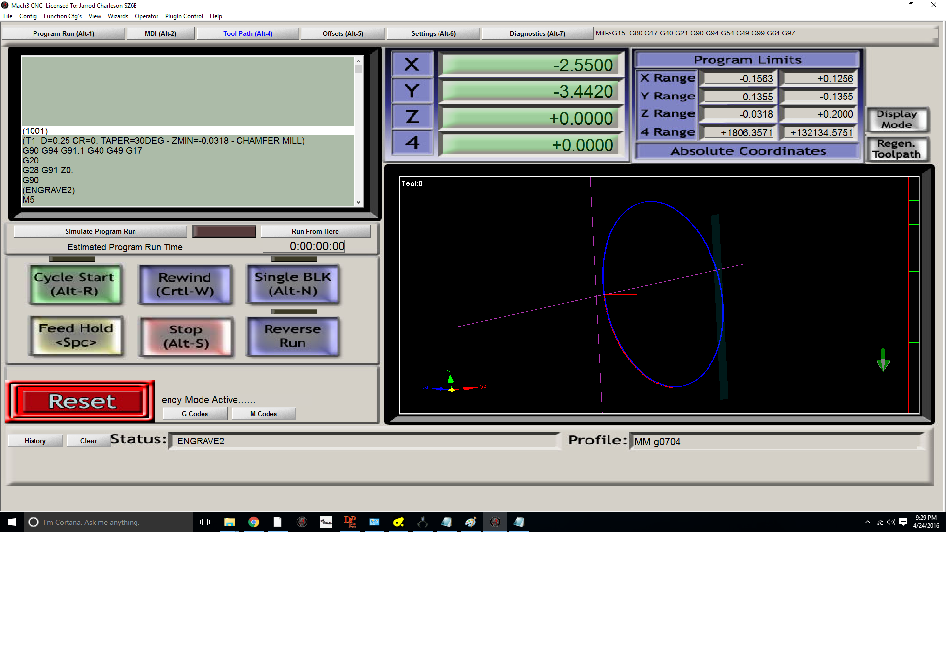

Ok ive changed all those settings and used the new post processor you linked. Im still getting the big blue circle in toolpath.

Message 29 of 63
Same thing. I linked a pic. Im running Version R3.043.062 of mach3. Im guessing im having the issues within mach3

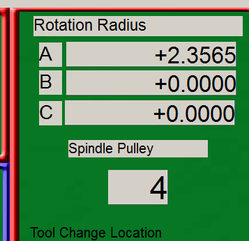

@Anonymous Right screen shot's of what you need to do
once you have settings set like above you should get the same out come as the pick below using the posted code.
now for some reason you only get a half circle in inch, Metric is fine I will have to dig in a find the problem.
also I would suggest you check all your other setting's and look through the Mach 3 manual tp
