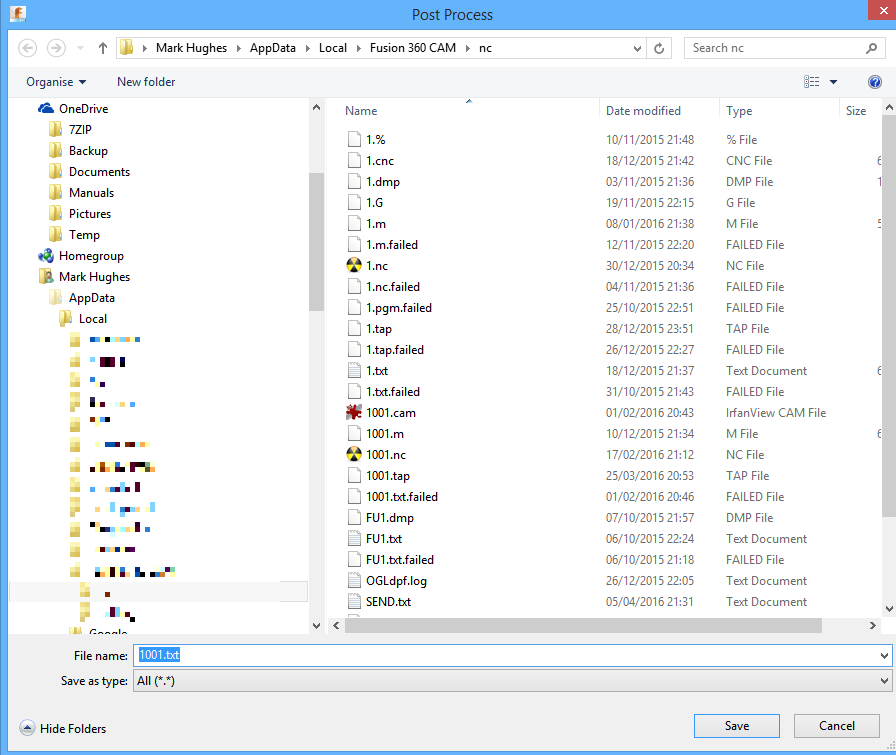

You are making this hard work. What are you seeing can you post a screen grab of how far you've got. If you've pressed the post icon on the next dialog pick the post for your machine then click ok you should then get a save dialog, just pick a location to save to and enter a name.
Post Dialog pick your control under Post Configuration and pick an output folder
Save Dialog, pick folder and file name and save..

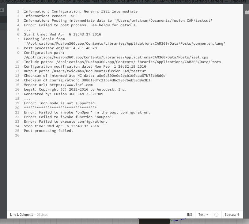

twickmanHZ4PK
here is a screen shot of the file i was able to save, as you can see it is failing to write. sorry, im not very smart.Screen Shot 2016-04-06 at 9.45.22 AM.png
Message 12 of 41
dave.anderson
Seems that the ISEL is a Metric Only post. You can design in any unit, but you'll need to change the Unit in the Post Dialog box from 'Document Unit' to 'Millimeter'.
