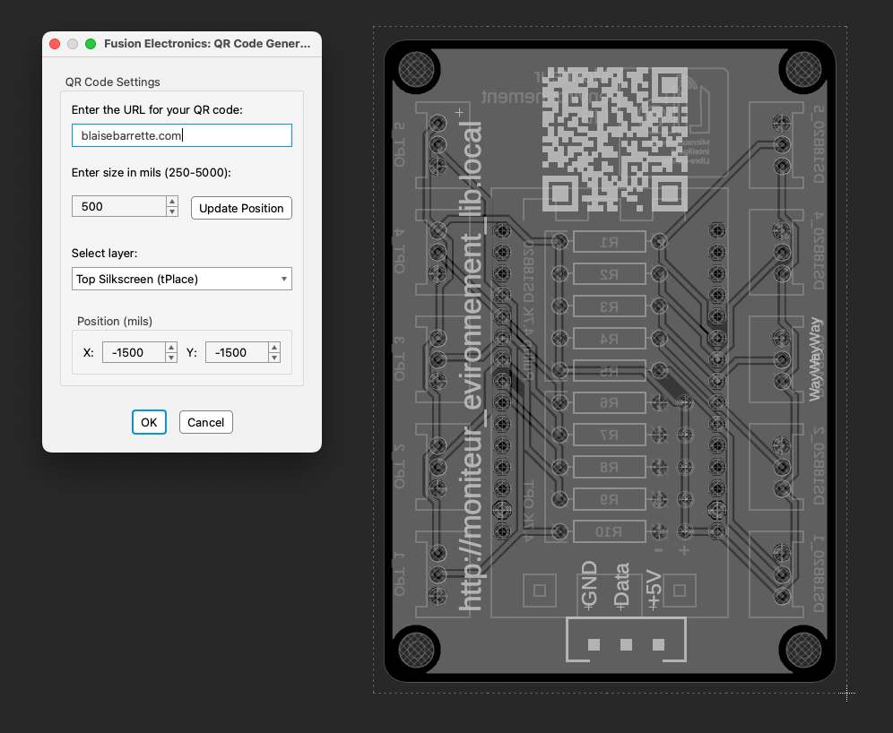

Hi all!
Importing images and logos in Fusion electronics can be quite tedious!
Importing DXF ability helps a lot but doesn’t works for QR Codes.
I decided tu tackle the project of making a ULP that would automate the creation of QR codes.
From the looks of it, I seam to have succeeded! For me anyway, on my machine, making a QR code in Fusion electronics is a breeze!
At this point, I would love to have testers. If you could try it and let me know your thoughts.
I couldn’t find a way to make a version that would work on both the Mac and the Windows machines. So I made a ULP for each.
The Windows version hasn’t been tested yet.
here is the address to the Github repository: https://github.com/blaisebarrette/QRCode-ULP-for-Fusion-electronics
Please take notes of any error messages or odd behavior.
Also, if you have any suggestions for future development don’t hesitate!
thank you!
- Blaise

Message 10 of 10
blaisebarrette
I just made a significant update to the ULP. Previous versions relied on a piton script hosted on a distant server. Now all the code necessary to generate the QR code is within the ULP file.
If you have a version older than 1.2.0, please install the latest version. If you test it, keep me posted!
Thanks!
