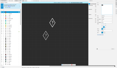

that's a great workaround. Do you still use this? Because I tried it and unfortunately, it does not work for me. I installed the TTF font and I can even find it in Fusion - even the preview shows the correct symbol (an ESD susceptibility warning) - but I can't place it. It just shows a placeholder symbol:

I tried it again but unfortunately it did not work. I even installed the same TTF as you (mooretronics). Below you can see that I set up everything like you did. The layer is a different one but it's the layer I use for my silkscreen. I also tested other layers without success. You can even see that the character map is recognized correctly. The output still remains as ASCII symbols though.
This made me think that it might be an issue with Windows - more specifically with the language and region packages (some time ago I had an issue with 3D models and this was the reason). So I installed the ones for USA (I`m from Germany). After restarting my PC for a couple of times I came to conclusion that this does not fix it.
Then I installed the TTF for all users with Admin rights. Again, it did not resolve the issue.
Now I'm pretty clueless and confused since I did not do anything differently but it still does not work for me. The correctly displayed character map only adds to the confusion.
I would appreciate further help in resolving this issue.

Looking at the snapshots you posted I think the only other explanation is taht you have the Always vector font preference option set:
Can you please check this and un-check that check-box and that should fix the issue. I am pretty sure this is the problem because looking at the font that is used it is definitely the internal Fusion vector font instead of being the selected True Type Font as expected.

fixed it! Apparently an oversight on my part. I was so sure I had it unchecked. I even recall unchecking it... Doesn't matter. It works now, thank you very much!
