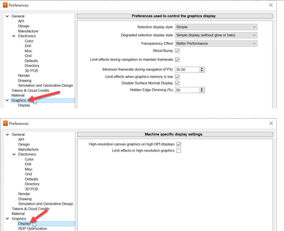

dan.banach
Hi @CullenrVDZDT
Thanks for posting the files. On my Windows computer I can open the .f3d files and the text is displayed correctly for both the 7mm and 8mm files. Assuming you see the same thing on your old computer.
I wonder if this is a high resolution display issue.
  1. What is the display resolution on your M2 mac?
  2. Under your Preferences, what are your settings under Graphics and Graphics > Display.
This is a holiday weekend in the US. On Tuesday I'll ask the engineering team for their insights.
