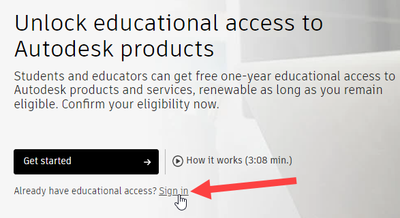

dan.banach
Here is the solution to Renewing your Autodesk Education Plan and Fusion 360 license:
students to Renew their Autodesk Education Subscription by doing the following:
  1. Navigate to the Get Products page.
  2. Under the Get Started section click Sign in and log in with your Autodesk Education credentials (same email and password you log into Fusion 360 with).
  3. Click Renew Now or Renew Access in the personalized banner notification.
  4. Under the Fusion 360 product card click Get product-
  5. Then click ACCESS
1 Year Renewal Reminder
Your access to the Education plan will expire at the end of one-year. You can renew your access annually as long as you are eligible. Thirty days before the expiration of your one-year Education plan access, you’ll be sent an email reminder. You can also find your expiration date in the personalized banner notification when you sign in to your account on the Autodesk Education Community website. If you do not renew your access, your free access will end when your Education plan expires.
