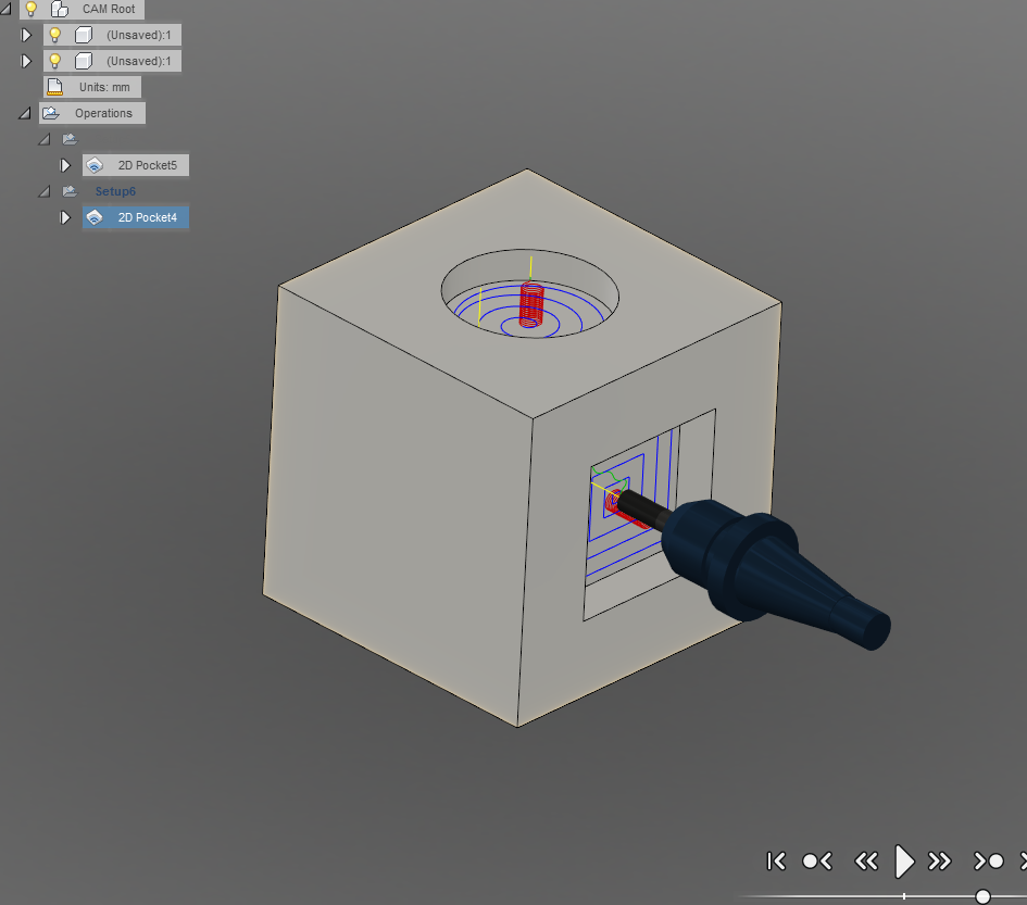

I'll try and answer your questions, in this post I'll deal with CAM setup. I don't think you've understood that the setup in the model workspace doesn't restrict how you can set the job up in the CAM work space. I've done a screencast showing how you can have 2 setups on one part to machine different side, f3d file attached. Note when I post the code at the end the output matches the origin in the setup not the origin from the model.
Here,s a picture of the test part with pockets in 2 faces. Link to screencast
Watching the screencast I noticed I forgot to select the model in the setup, for a single part it works OK but with more parts in a design you need to select the part you're machining.
Mark
