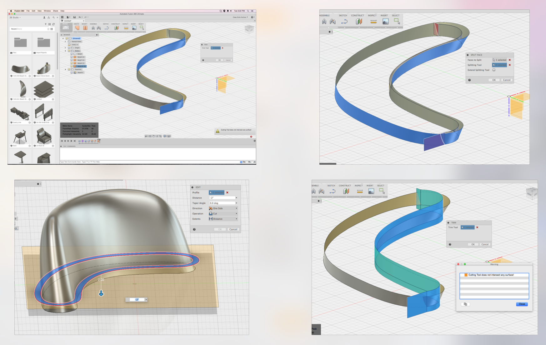

unable to trim split no intersections found
cekuhnen
so logically fusion should be able to find the intersections here for splitting, it does not
same with surface and even solid substract (lower left example)

jeff_strater
Hmm...  Yeah, this looks like a bad bug to me.  It doesn't even work when the surface is extended.  Thanks for the files, we will look into it.

cekuhnen
at the end I needed to do it this way
but the cut extrusion needed to go up as well.

jeff_strater
Just FYI - I have filed these bugs as FUS-15691 and FUS-15692. We'll try to investigate and fix these.
