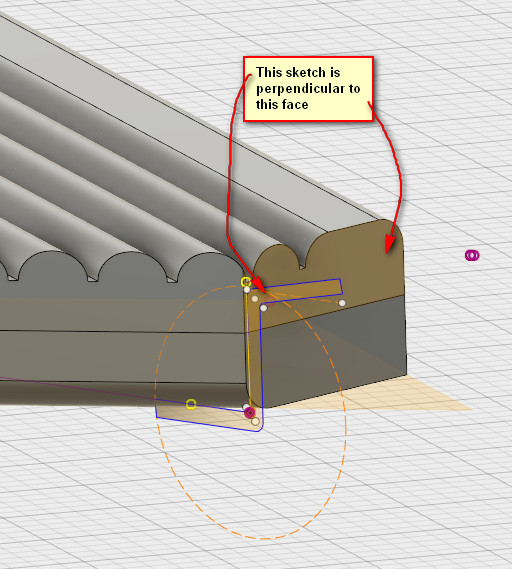

This is my first ever F360 drawing, so please forgive any stupidity.
I want to create a little bracket that fits on a face that's at rather an odd angle to the standard Left/Right planes.. I defined a sketch plane on another component that's perpendicular to the face, and created a sketch of the cross-section of the bracket. When I try to Press/Pull the sketch profile, it appears the work, until I press OK, when it just disappears. I've tried all the ways I can think of, but I can't figure it out.

I can tell from the pictures that your doing a cut instead of a new body. The fact that the extrusion is red shows this.
In the press/pull options box switch the operation from cut to new body.

Thank you, that was the problem. I'm almost learning more from building my own project than I did from watching/doing the tutorials.
