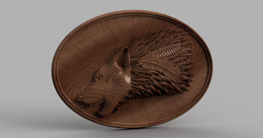

@JDMather needed a tutorial for his student to make something like this.
His student drew the wolf picture used to make this tutorial, if I had her name I would post it.
The thread is located here:
https://forums.autodesk.com/t5/design-validate-document/performance-review/td-p/6617671
This was done entirely in Fusion with T-splines and no other apps.
