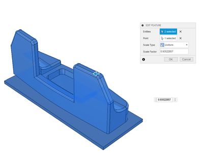

Just for a test I took your example that weighs about 303g and scaled it to 500g like this. See attached file.

As @HughesTooling says, use the Scale command.
For the scale factor you'll need to enter the cube root of the mass ratio. i.e. 0.93522857
