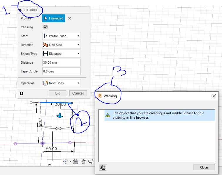

gillesht
I have the same problem and my sketch folder is on (the light is on). What am'I doing wrong?

AndrewSears
Can you supply a screen shot?  Make sure the sketch folder is expanded.

gillesht
The screen shot is attached.

gillesht
When I try to create a revol with the sketch shown I get the message The object you are creating is not visible. Please toggle visibility in the browser. As you see on the screen shot the sketch folder is all lighted.

schneik-adsk
When you do the revolve can you click OK? Then see if the body folder is turned off in the browser?  Somehow I think you may have turned the body folder off while working and now there are no bodies (did you delete some earlier?) so as you try to make the revolve it thinks that the body is invisible.
Kevin Schneider
Message 10 of 16
gillesht
Yes I've deleted a body and the body folder lost its visibility. After the revol I've toggled the visibility back and the result is OK.

bayupranotost
I have a same problem with you, then i found that this problem cause the bodies that include a sketch was invisible. So i have tried to visible bodies first then extrude my sketch and successfully with that way.

davebYYPCU
Toggle Visibility means clicking on the eyeball for the body and it's Browser Folder,
If the Bodies folder is not there, make your body, and then you will see the Browser items.
