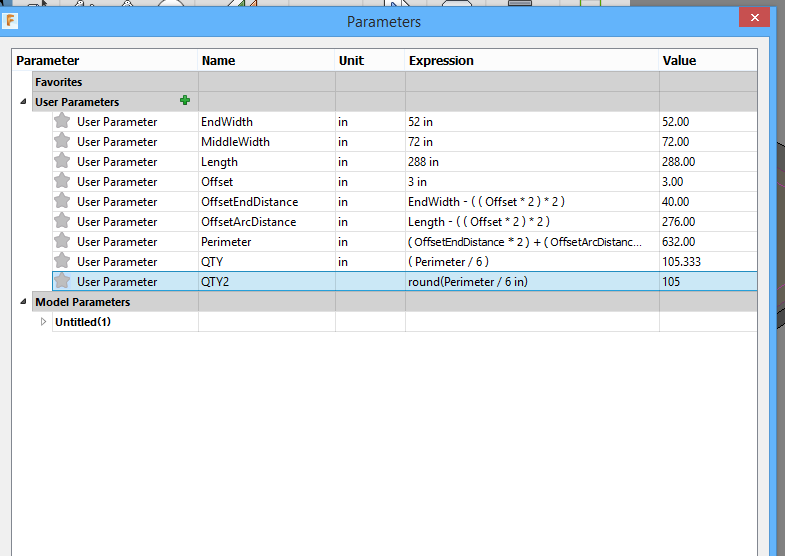

I'm having the same issue. I understand that I have to make it unitless and I think that I have but it still won't work. I have tried a bunch of different combinations and I would appreciate some help if anyone has the time! I attached an image of my parameters. What I want to do is pattern a feature along a path. The path is the perimeter of a shape and then I have the quantity calculated by (Perimeter / 6). QTY2 is just another attempt at making it work by making the parameter unitless. Once again any help would be appreciated!

Can you export the file as an f3d and attach, you can delete all of the model info if you like just leave the parameters.

Everything is there. Just to give some info on the piece, this is a test model for a conference table top that has a solid wood edge and a MDF board in the middle. The MDF has holes cut into it every 6 inches or so for the two pieces to be glued and clamped together. I hope this helps!

I think the problem might be because quantity need to be a whole number, try this. Here's a link to help on parameters and what's available.

That was the problem, thank you so much!

This was definitely the problem - I created a parameter for use in the 'pattern on a path' command - the pattern was a tilted coil winding on a double helix solenoid.  The number of repeating patterns depended on the length of the solenoid - I calculated the NumTurns by dividing the SolenoidLength by the LengthOfEachTurn...even though I divided each value by 1 mm AND specified NO UNITS for the parameter it still was not working..i.e. (SolenoidLength/1mm)/(LengthofEachTurn/1mm) ans. in NO UNITS....The Fix was this: round((SolenoidLength/1mm)/(LengthofEachTurn/1mm))...Note that the answer BEFORE 'round' was a whole number!  Also note the answer was UNCHANGED by the addition of the round command.  Additional clue was when I put NumTurns in the pattern on a path dialog, it displayed in red before the addition of 'round', and NumTurns disappeared and was replaced by a number when pulled up the dialog next time - once I added 'round' NumTurns stayed and was not red...
