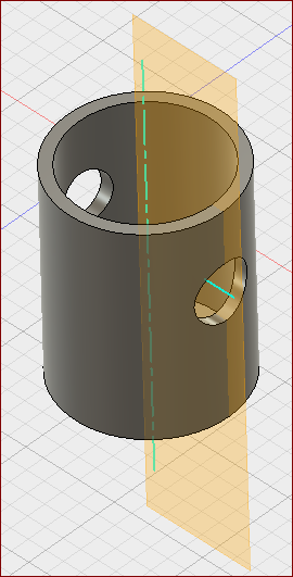

Hi I think this "Hole" problem happened after they had improved the "Hole" command that will spread the holes automatically. Since you are at the Direct Modeling mode you can try to offset a plane, then using "Move" command to rotate or move the plan to a postion that is bearly touching your cylinder, then you can create the hole. If you want to make a slot, maybe the "Slot" command at "Sketch" can help. Try using a plane. Hope this will solve your temporary problem.

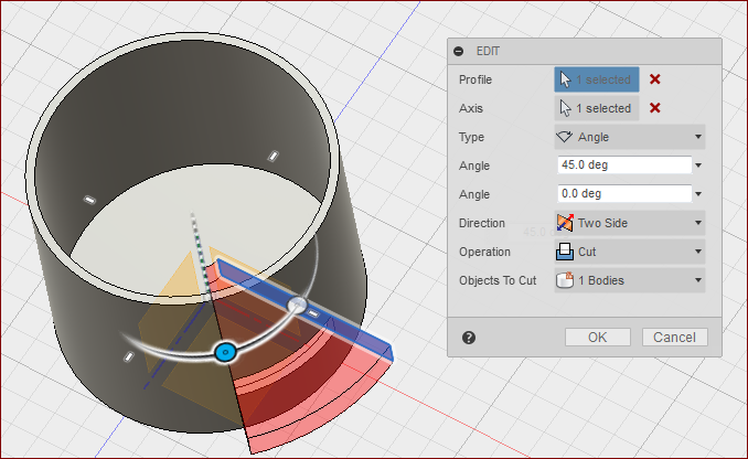

Yes, we don't have a straightforward way to do circumferential slot around a cylindrical surface. Can you propose this on the Idea Station?
Regarding modeling slot -
There is an old thread on this. http://forums.autodesk.com/t5/sketching-sculpting-modeling-and/sketching-or-sweep-revolve-on-cylindr...
Kingson, I tried with the slot sketch and got it projected on to the cylinder but then don't know how to cut it.
I'm sure you must be aware of this. I would do a slot something like this -
1. Create a rectangular sketch perpendicular to the intended slot (width = diameter of the slot end)
2. Revolve cut it to the cylinder to the required degrees
3. Fillet the edges (radius = half the width)
On the vertex available for hole on outer cylindrical face - I didn't realize that the outer curve of the hole is split. As you said the other curves formed by the hole with other faces of the cylinder is not split. Its interesting that you find the split edge useful.
I would then just split the hole faces -
1. Create 2 work axes, one for cylinder and one for hole.
2. Create a workplane passing through these 2 axes
3. Use SplitFace command, select the hole faces and workplane as splitting tool.
