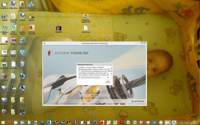

After forced restore Windows 8.1 64 bit I have a great problem with start Autodesk Fusion 360. Attempt of the start is finished  with the message - see the picture trouble_1.jpg.

It appears that there may be a mismatch between the installation record and the actual state of your system.
To reset it and start afresh, delete the folder C:\Users\krzysztof\AppData\Local\Autodesk\webdeploy completely, and re-install from the usual place.
Thanks , succeeded in.
