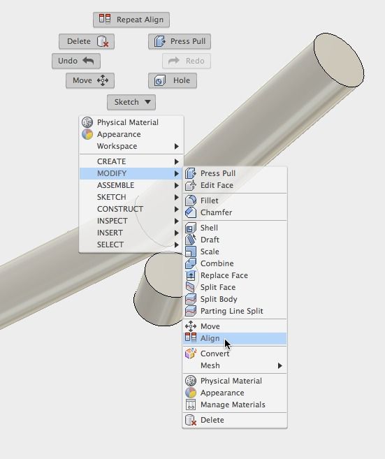

Why does fusion make it so hair pullingly difficult to snap to the centre of then end of pipe I have made. (see pic)
What good is only being able to snap to the edge if I need to line the centre of the pipe up with the centre of an outlet port.
Please can someone help.

Hi, maybe I can give you a few ideas here. I am a user of the program, not an expert or its software developer. There are a few ways but I will suggest two ways here.
a) Using "Align":
Without forming components from bodies (works on components as well)
1)  Use the "Construct" menu and select  "Point at center of circle/torus/sphere". This way you can just click construct menu, and select the "Point...."  then click the end of the pipe and the other opening, you will form two points at the center of both pipe and the other opening.
2) Select "Align" at the modify menu and click both ends. They will be aligned:

I think what you are looking for (and I have been as well) is the ability to use the move tool to select the two centers and move one to the other.  That’s part of what is being asked for in this, one of the most voted ideas in the Idea Station:
 http://forums.autodesk.com/t5/fusion-360-ideastation-request-a/object-snap-is-really-needed/idi-p/38...
But the Align tool now works well in this context, and will allow you to snap centers. It is no longer necessary to create construction geometry to snap the centers together- it was in earlier versions, but the Fusion developers listen to requests.
The example below is a solid in Model workspace. For a surface as in your example yo would select the outside edge of the end, and it will snap them concentric.
Select the Align tool:
Select the point on the part you want to move
Select the point you want that to snap to
And it shall be done as you specify ;-).

Thanks for your replies but neither the align tool or the joint tool will let me select the centre of that pipe opening. On the photo if you can see that little line which I guess is the seam of the pipe, that's the only point of the circle end it will let me pick up, which is useless for what I need to do 😞
Also when I try and make a centre point through circle in the construct menu, it wont let me select the pipe.
This software is so frustrating at time. Simple things made extremely difficult at every turn.

Straight pipes created in the model section are fine and will pick up from the centre. Its the ends of pipes created in the sculpt window that just wont pick up. I checked selections and they are all enabled. My fix mentined above by creating a small solid disc in the centre of bothe ends worked as it allowed me to use the joint tool rather than the align tool. Align is great but once I had the pipe aligned into the outlet socket, it would always come out in the wrong rotation.
The fusion team need to add the ability to program in the angle of the align function, much like the joint function where it can rotate on its snap point.

Hi there I also uploaded your f3d to my Fusion and I had found something and I attempted to fix for you. The Fusion Team might have other ideas but this is what I had found.
1) Your tube is an opened Patch type surface, not really a solid that can be selected. Screen Shot 1, body (30) is showing that it is a patch type surface.
To do that, I had created a solid cylinder with a hole in between called Body (32) in  Screen shot 1 to show you the joint action. I had dimmed out your other components.
Now you have to give your pipe Body 30 some kind of thickness to become a real solid. So you go to "Patch" workspace (Parametric Mode fine here) select your Body (30) and select Thicken. For example, I thickened that by 2.00 mm.  Screen Shot 2
You will see my Body 32 right next to your pipe, now a solid with a wall thickness of 2mm.
Now you switch back to "Model" workspace by selecting that at the browser window. Now you should be at the Model Workspace and you can see clearly Body32, the one I had created, and a new solid Body33, the one you had added a thickness of 2.00mm to surface patch body30. You can dim out the light bulb of body30  now. but do not delete that. Not at the parametric mode.
You cannot use "Align" here because it will not work on your pipe due to one reason or another. But Body 32, the one I created can. So to joint them together you have to use Joint at the Assembly menu.
To do that you have to create components from bodies. You select that at the browser top bar. Then you had created two new components: Component 37 and component 38.
The pipe (now a component) could not use Construct to get a mid point for some reason, so you have to use "Joint Origin" to create a joint origin and move that to the approximate middle of your pipe. There are ways to get the mid point of your pipe but that is another technique that you have to find out yourself. Not the scope of this simple demonstration. The Cylinder I created does not require that because it is perfectly round.
Now Click Joint and select both of your pipes (yours and mine) and they will joint together the way you wanted it:

My last Conclusion of your file: EASIEST IS TO DELETE BODY30, and use PIPE from the model workspace to create the pipe, select "Hollow" and give it some thickness. That will work with "Align"
My demonstration above just shows that if Body30 is created but the Sketch line deleted, then you have to do it that way. I found that your sketch line is still here. So Delete Body30, and use Model Workspace, Pipe to create a good round pipe!

Alright so parsing through the past few posts it looks like there have been a few questions that have come out, let me see if I can help answer some of these.
Issues:
1. Unable to snap to the edge with pipe that originates from a T-Spline body.  This is shown in the model you have sent me.
2. How to create a pipe with a bend in it from the model window
3. Align doesn't have the ability to define an angle
1&2. Unable to snap to the center with pipe that originates from a T-Spline body.  This is shown in the model you have sent me.
As mentioned above the model that you sent me has a pipe that is referred to as Body30.  Looking at your time line, this body was created by leveraging a sketch with a couple straight lines, an arc acting as the bend in the pipe, and using that as the path for a T-Spline pipe body.  After that you exited the Sculpt workspace and the t-spline body was converted into what looks to be a surface.  The problem you have now is that you are unable to snap to the center of the pipe.  So there are two ways to approach this, we can either leverage the existing work you have done or we can create a new pipe.  If you are looking to do a lot of pipes and are expecting to do a lot of aligns, then I would recommend we create a new pipe.
It looks like you are leveraging a parametric model so we will try to keep with that.  One way to create a pipe is by using the sweep command instead of the pipe command.  I have a feeling that the reason you used a t-spline pipe is because in parametric models we don't have the pipe command in the model environment, though it does exist in direct modeling.  If you use the same path that you did with the t-spline body and create another sketch at the end of path with the profile you are looking to use, you will be able to create the same pipe, but it will be parametric and it will have the center point that you are looking for.  See the video below for an example with your model.
The other option would be to use a BaseFeature instead of the Form so that you can leverage the pipe command there.  After you create your pipe you will have to exit the BaseFeature so you keep your parametrics.  The downside to this right now is that you won't have any parametric control of your pipe, also if you need to create multiple pipes this may cause additional work.
If you wish to leverage the existing pipe that you have already created, you can use the Plane along Path command, and then offset another plane to the end of the geometry.  With the work plane created you should be able to project the geometry and then create a center point there that you can create a joint origin from.  This is something you may have already tried, and it can create some extra work.
