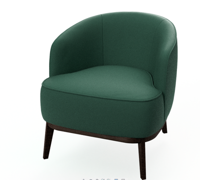

I have problems with rendering Mesh object in fusion. In preview mode everything is ok, but when I do the final render an error appears, a shadow appears on the texture, and the quality of the fabric is bad.
What am I doing wrong? or is it a fusion error?

But is not the same problem. I test the bottle file and I don't see any problem. I change for other fabric texture from Fusion and happen the same.
And more, when I apply the same texture to different object: mesh and solid body the dimension of the fabric texture are different.

Isn't the first sofa you affixed an imported model?
There seems to be a problem with the rendering of the imported mesh.
Imported meshes might not import with proper UV mapping, if they have UV's at all. .stl mees for example don't contain UVs.

Yes, it happens with all mesh models I use.
